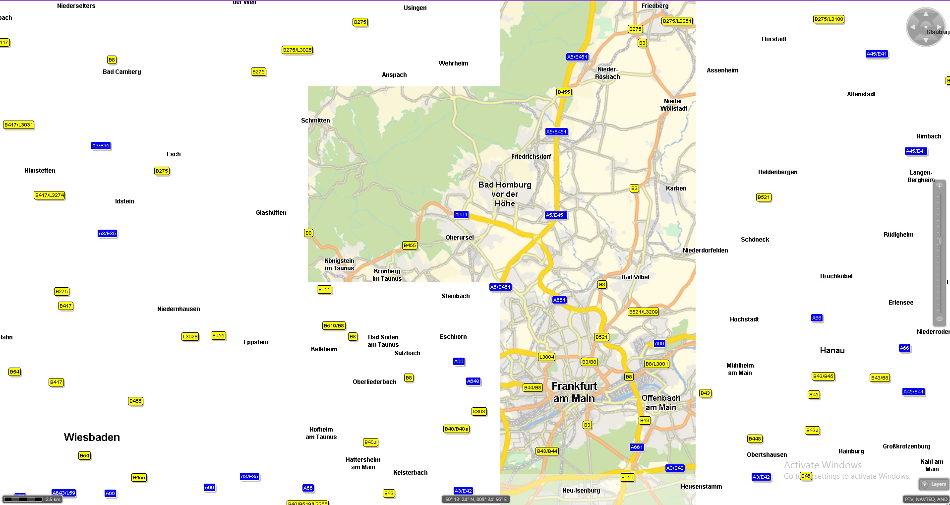

- We have used WpfMap Control and it takes about 8 to 10 seconds to render full map in application as shown in Image.
- Is there any way to load map faster?

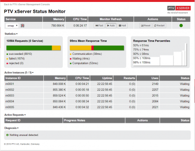

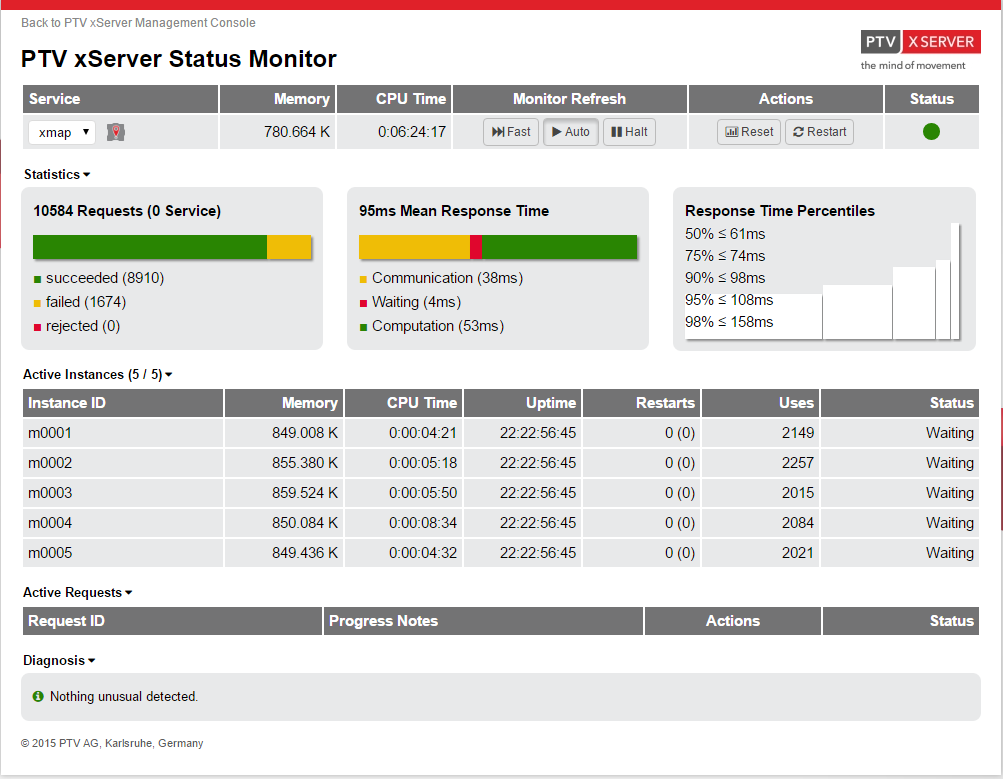

- PtvStatusMonitor_India screenshot which is loading map faster (< 2 seconds) on full screen

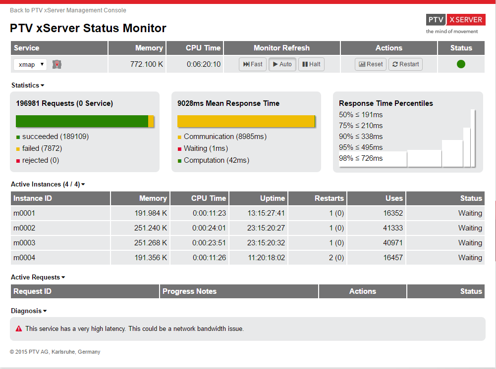

- PtvStatusMonitor_Germany screenshot which is loading map too slow in India as well as in Germany

If the queue size would be not enough, it would show in the monitor as rejected requests. This value however is 0. Also the computation time is a value I would expect so I doubt that the server is overloaded with to many things to do.
If I look at the screenshot I'm seeing one big issue: the "Germany" server needs 9 seconds of network time on average over a pool of many requests (communication average = 8985 ms). I would look for the issue in your network and not in the xServer or it's configuration.
