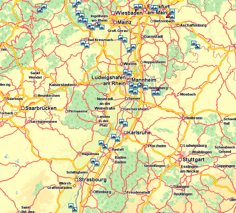

is it possible to display the native static layer called CombinedTransports with the xServer.NET control? How?
The layer shows piggybacks / trains and ferries.
Sample screenshot based on a native render map call towards xMap 1.26. The render profile CombinedTransport was applied and also the StaticLayer "CombinedTransport" was requested.

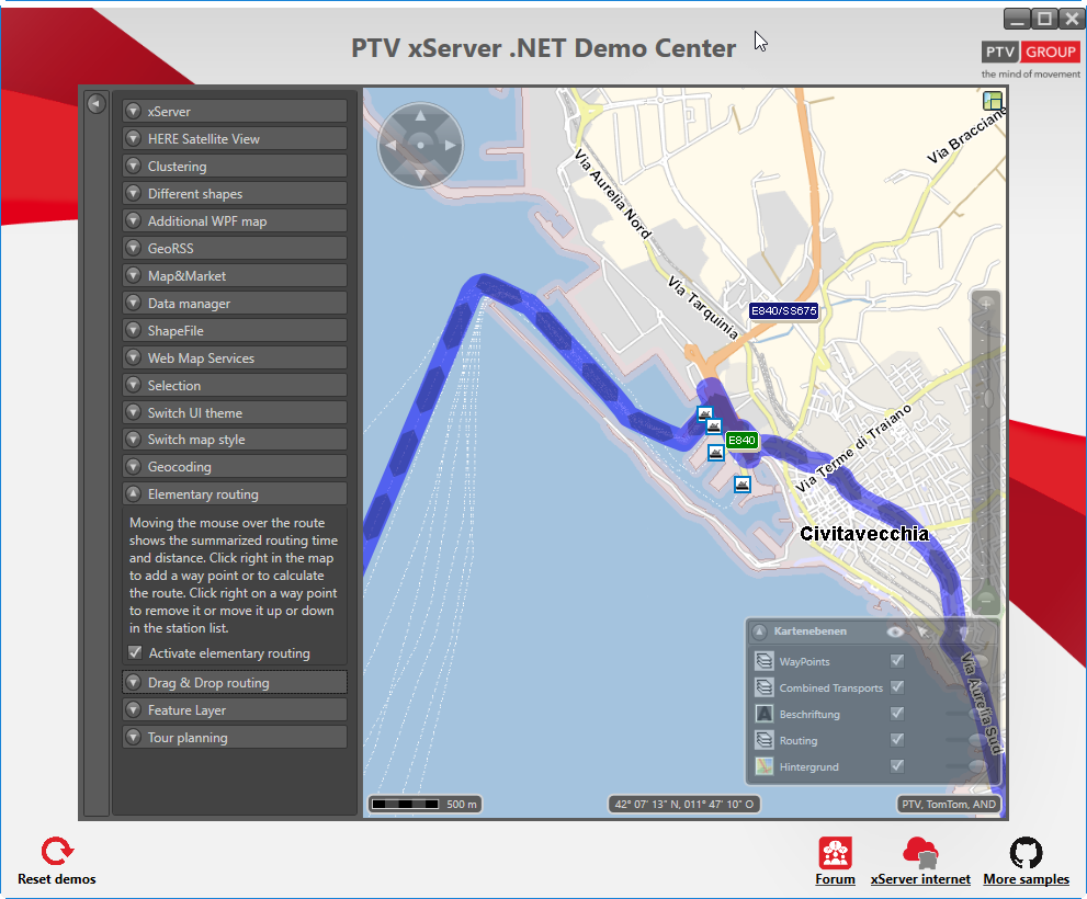

you just can add the Combined Transports as standalone xMapLayer, like POIs
map.Layers.Add(new XMapLayer(layerName, xMapMetaInfo.Url, xMapMetaInfo.User, xMapMetaInfo.Password)
    Caption = "Combined Transports",
    MaxRequestSize = new System.Windows.Size(2048, 2048),
    MinLevel = 4, // Minimal level (defined by Google), for which Poi objects are shown.
    CustomXMapLayers = new xserver.Layer[]
        new xserver.StaticPoiLayer
            name = "CombinedTransports",
            visible = true,
            category = -1,
            detailLevel = 0
