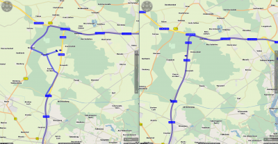

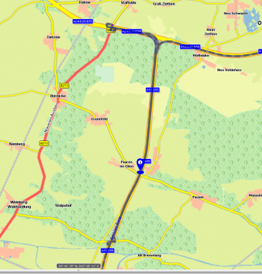

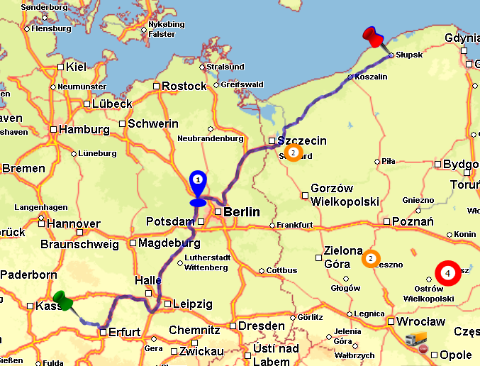

Let's consider below route:(Grossengotten -> Fuzzy via point near Berliner Ring -> Słupsk) (Fuzzy radius is 1000 m)
When Fuzzy via point is on the right side of highway ...
The route is as supposed to be:

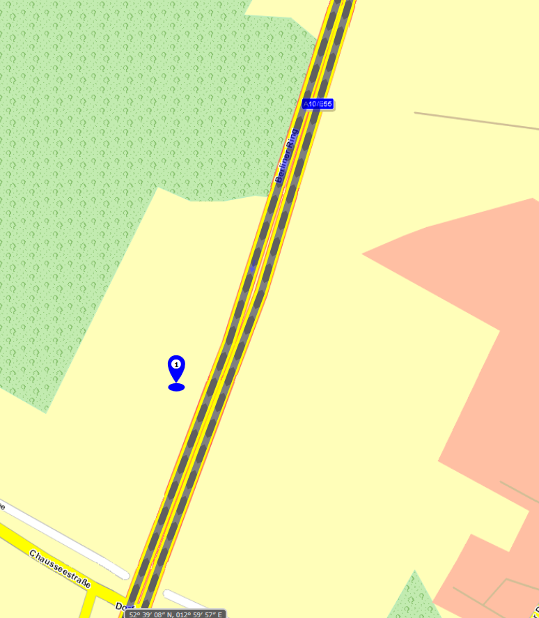

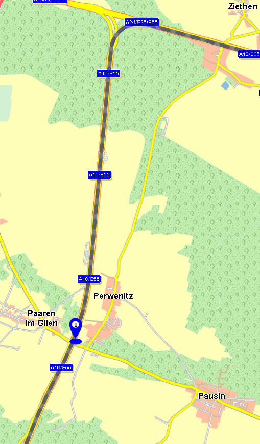

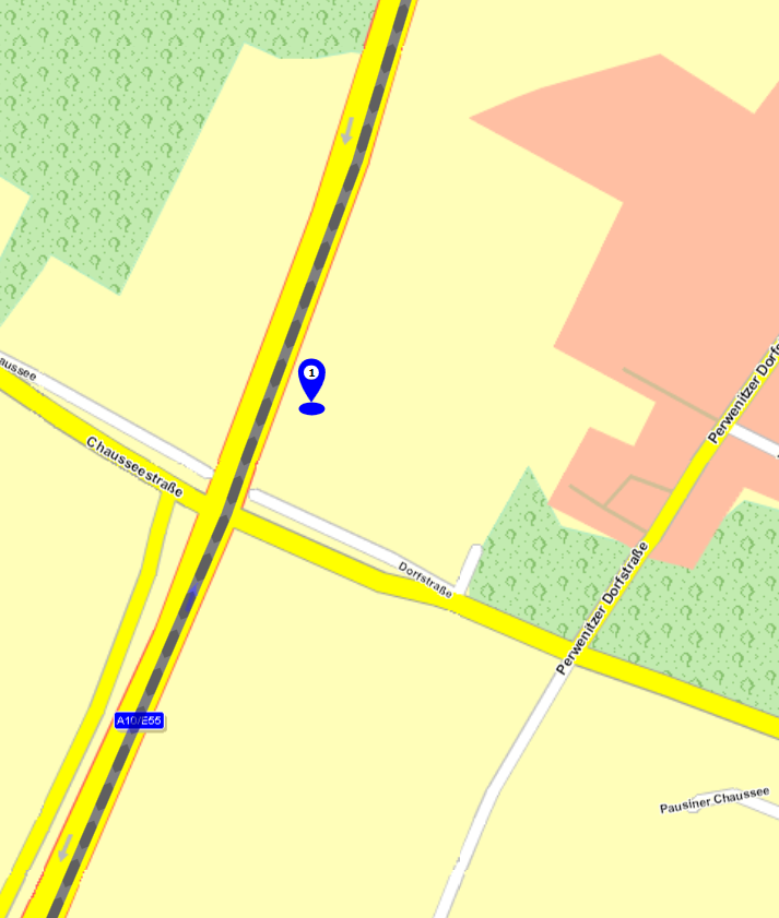

But if user puts Fuzzy via point on the left side of highway...
The route is far from ok:
Even though It is near fuzzy point (less then 1000m), It turns back. Then It goes near the Fuzzy point, turns back again and goes to It's destination Point (Słupsk).
Our users complaint a lot on this. They would like from Fuzzy point and It's radius, to act as Fuzzy Point in a circle shape.
How can we do this ?
Is it even possible ?
