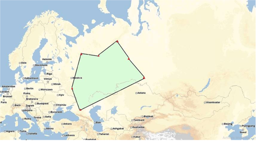

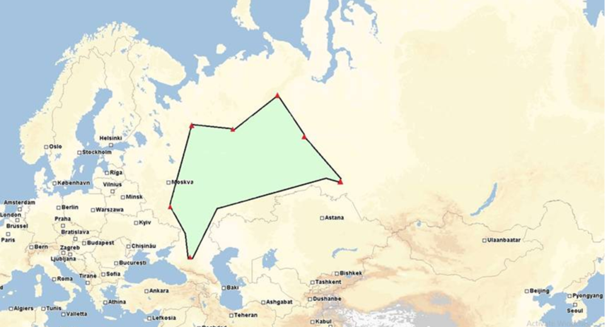

I am using Ajax Map and need to show all given geo locations covered in an area as below:
Expected map view, it should cover area within given region/country
For now we are using Polygons to cover area/region but can't achieve/meet my expected result. Covered area is crossing border of other countries, you could see it in below image:

I have few cases/issues:
1) It should work with large set of data/geo locations.
2) Any other ways to achieve above requirement.
Please let me suggest, how can I get my expected outcome.

think this isn't a possible with the ajax control out-of-the-box. It seems you need some GIS methods for your task, i.e. intersect your polygon (which is a convex hull?) with the polygon of the country border. This means you also need those country borders as polygons plus a geometric library (for example the geo-functions of D3 https://d3js.org/).
Another solution for your problem could be the use of voronio-regions with d3-voronoi https://github.com/d3/d3-voronoi, see http://oliverheilig.github.io/voronoi-territories/
