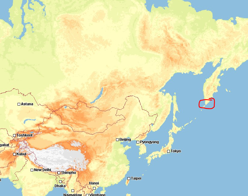

we are facing an issue about routing in Russia region kamchatka. After Bernd suggestet Parameter onlyReachableRoads we get expected outcame. But we are not sure about the influence of this parameter to our normal tour planning.
We need an explanation of this parameter.

Looking specifically to your example: you wrote that you are routing in Russia. The map data in Russia does not have complete coverage of all the know roads. Sometimes this creates isolate area's in the map especially when trying to route to smaller villages. Setting onlyReachableRoads to true will at least find the nearest main road so that you can calculate your route.
Last comment: it is not possible to visualize the flag to get an idea is a area is isolated or not. I would strongly advise to always keep onlyReachableRoads on true. If there is a reason why you vehicle is allowed inside an isolated area our engine will pick up on this.
