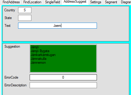

I made a simple test:
Jämjö found via Jaem...
So this looks promising for question #1.
For question #2 we do not have a solution so far. The format of the index is fix.
But I'll forward that topic to the xLocate team for future solutions.
