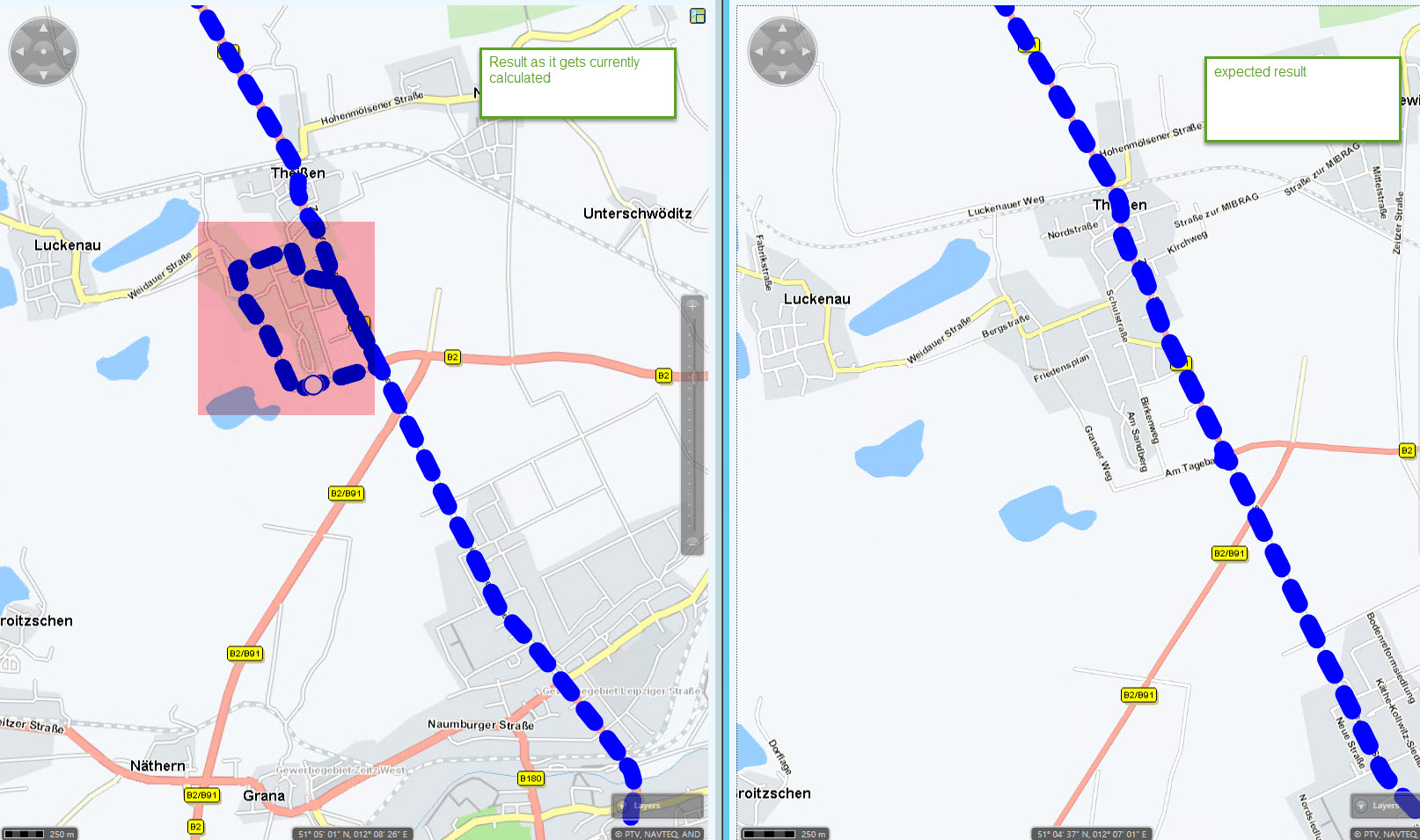

I am using the fuzzyRadius parameter in a via point but it seems that it gets ignored since it actually gets off the highway, passes the exact address of the via point, and gets back on the highway again.
My expectation is that the calculated route does not pass the fuzzy via point exactly and stays on the highway.

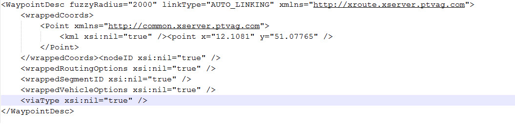

I am not sure if all the parameter in the request are set correctly. Currently we are using the following parameter for fuzzy waypoints:
Is the viaType also to be set to "Fuzzy"?

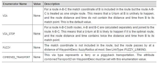

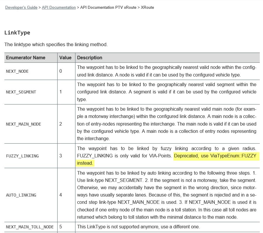

In your reply you've used linkType="FUZZY_LINKING", which as per 1.24 xRoute documenation is depreciated: Please what is the proper usage now?
1) viaType="FUZZY" together with linkType="FUZZY_LINKING"
2) viaType="FUZZY" and leave linkType to some other value (=by default we are using AUTO_LINKING)
May I please kindly ask you for your advice/recommendation?

I had this discussion with a developer before. LinkType=FUZZY_LINKING + viaType = null is the same as LinkType=AUTO_LINKING + viaType=VIA_FUZZY.
The behavior of LinkType=FUZZY_LINKING + VIATYPE=VIA is not defined, because this should not happen. FUZZY_LINKING became deprecated the moment the viaTypes where introduced in the interface. So in theory there should not be solutions using FUZZY_LINKING who also set the via type.
To give an answer on the question what to use: I recommend the LinkType=AUTO_LINKING + viaType=VIA_FUZZY for fuzzy points. AUTO_LINKING behaves much better near highways (especially crossings) then other LinkTypes for the fuzzy use case.
