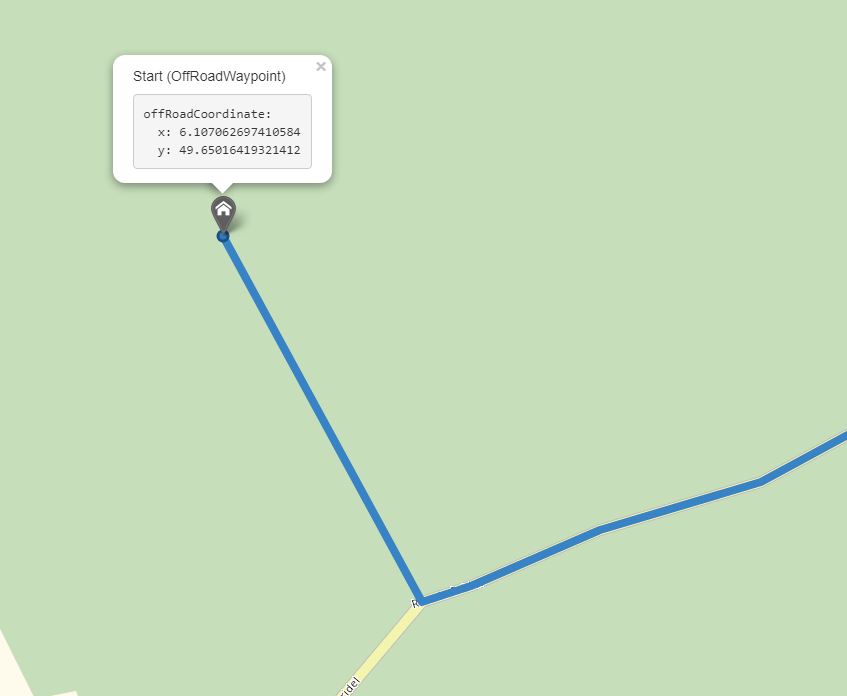

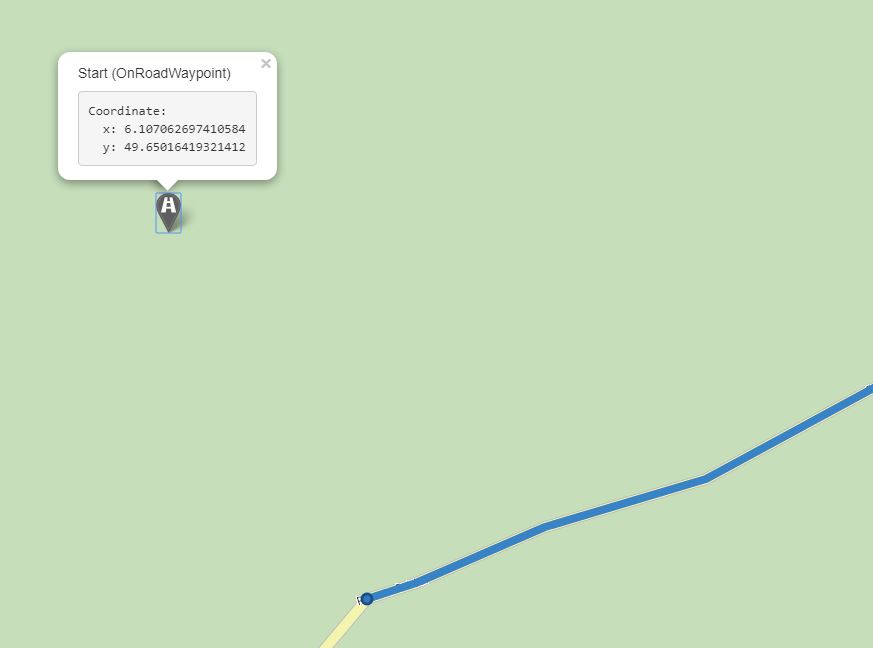

Re: off road
I do no thick that the fact your coordinate is Off Road is the issue. Coordinates in practice will never be exactly on a road especially if they are coming from a GPS device. Our engine will always try to link to the nearest road found up to 50 km away (configured in the RouteRequest -> requestProfile -> routingProfile -> linking -> maximumDistanceToSegment if you want to use other values).
The difference between OnRoadRouteLocation and OffRoadRouteLocation is NOT if linking the point to a network will succeed, but if the distance from the coordinate to the network should be counted toward the route or not. See the difference in the screenshots.
