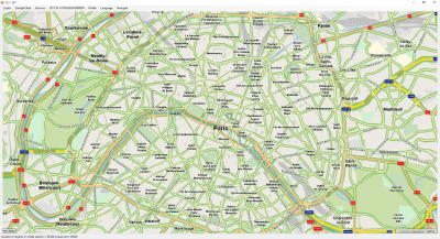

Optimization in Paris - distance matrix based on 24:00

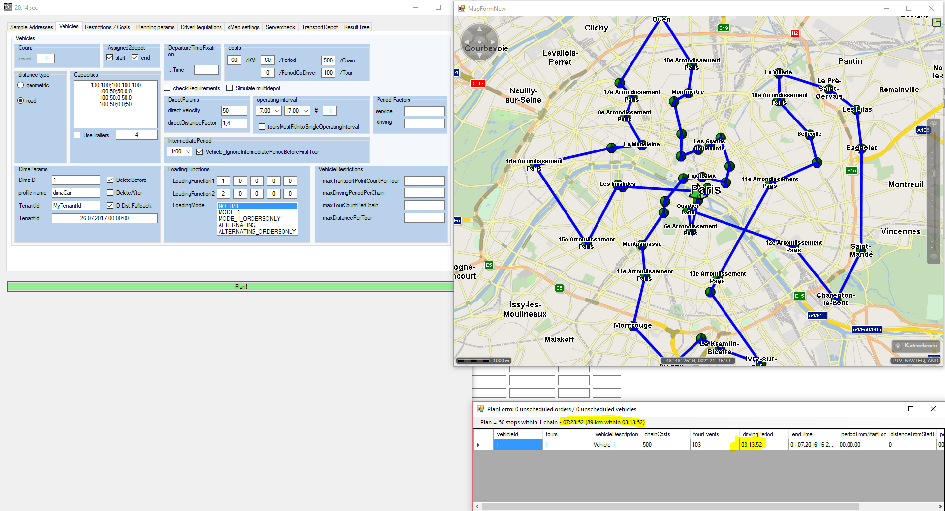

Optimization in Paris - distance matrix based on 12:00
As the distance matrices are different for these two timestamps the sequences and periods changed.

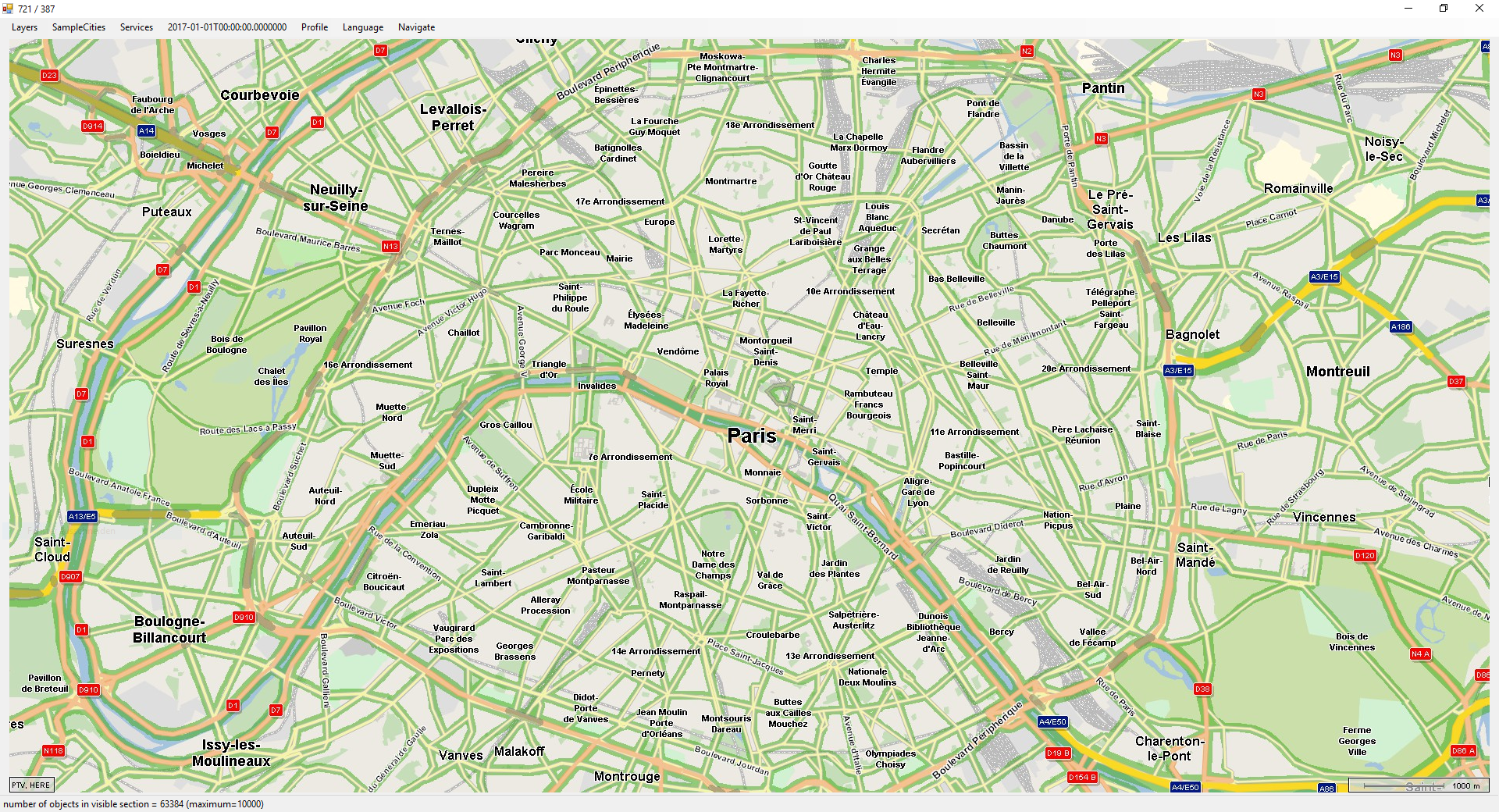

Paris with SPEED PATTERNS at midnight

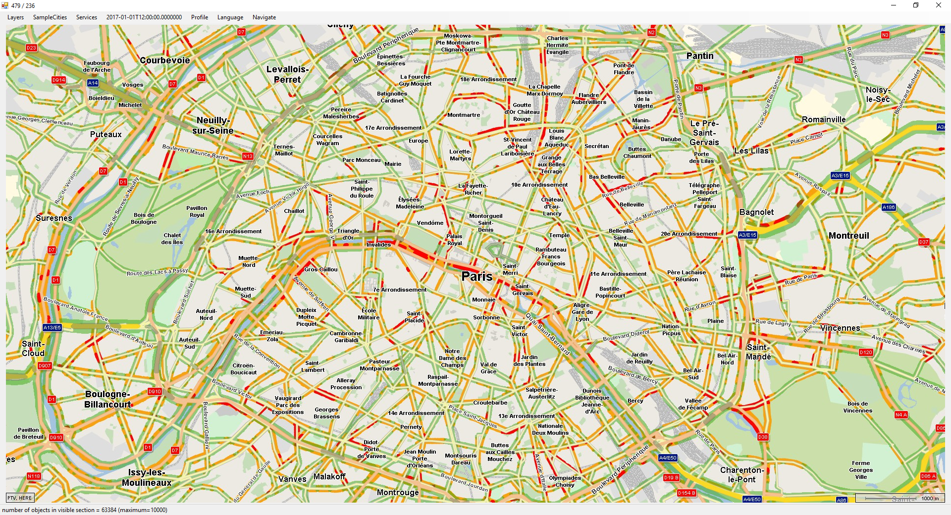

Paris with SPEED PATTERNS at noon
