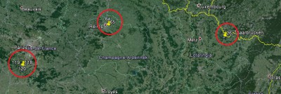

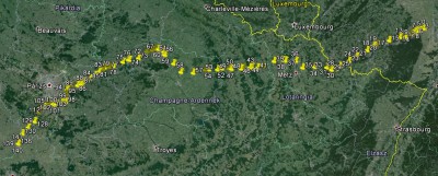

The original array of waypoints:
The points that are matched by XmapMatch:
(The google maps pictures are only for representation)
What can cause this behavior and how can I fix it?

Within xMapmatch there is a high need to make sure the profile you are using is configured to match the properties of your signal. Properties of your signal are for example your polling interval, accuracy of the GPS, etc. With the "wrong" profile you will quickly end up with a bad quality result, be it wrong matches or hardly any matches.
If I look at the picture you are of your input I'm guessing your polling interval is somewhere around 2 to 3 minutes. Our default profile is configured for a much smaller polling interval. This is way you are getting a bad quality result.

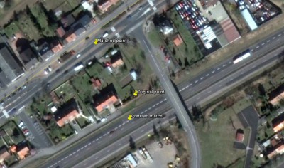

When using the local-matching profile, is there any way to set the preferred network class for the algorithm?
In some case the input coordinate gets matched to a road from lower network class instead of a (preferred) higher one. Even if the distance is equal from the input coordinate.
I've attached a picture which shows the example point matches.

there is no such thing as a restriction to specific network classes within the map matcher. So the map matcher should match to the closest road available - if the attributes match. Maybe the heading is wrong?
One thing you could try is reducing the linking distance. This is something you can always do when you know that you have quite a good signal.
