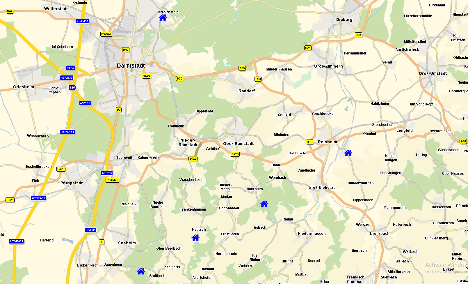

We are using the PTV wpf map in our application.
We are displaying the icons on map as displayed in screen_shot (IconsOnMap.png).
But issue is that, icon color and label color present on map are same, so its hard to see the icon as displayed in screen_shot (IssueWithIconColorAndMapLabelColor.png).
Questions :
1. Can we change the color of label displayed in map ?
2. If changing the color of label is not possible, then what would be the possible solutions ?
Thanks.

first you can try another profile with slightly other label colors. I think gravelpit has some lighter colored labels
https://ptv-logistics.github.io/xserver ... xserver-1/
If you have a custom xServer installation you also could try to modify the render.ini in the conf folder of xMap. But this is a bit awkward an not very well documented.
Without modifications of the server an option could be the application of client-side filters. In HTML there are CSS filters to modify the display of content, which can also applied to maps: http://oliverheilig.github.io/leaflet.webkit-filter/. This is very useful for data visualizations http://176.95.37.29/3d-heatmap/.
Unfortunately this is not possible for xServer.NET (= WPF). What you can do there.
* Reduce the opacity of the basemap layers.
* Insert a semi-transparent panel on-top of the basemap-layers.
* Hook into the tile-proider API and implement a blending for the xMap-Images https://softwarebydefault.com/2013/03/1 ... -blending/
OK, the last solution is a bit difficult to implement, but i can give a sample for the panel option.
Oliver

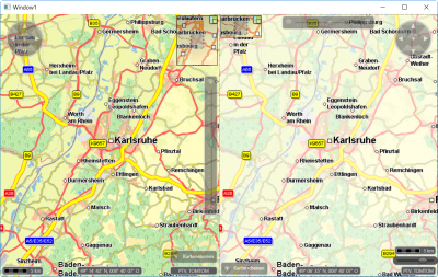

So here another option:
The Control has a hitten Dimmer-Gadget. But you have to Build your own Control-Layout to activate it, and it only manipulated the color of the background tiles. You can test it here (Project CustomLayout):
https://github.com/ptv-logistics/xservernet-bin
Oli
