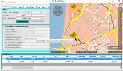

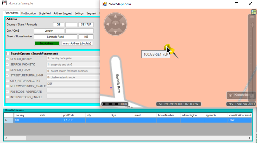

I'd like to look up "109 Lambeth Road, SE1 7LP, London, GB" with method findAddress:

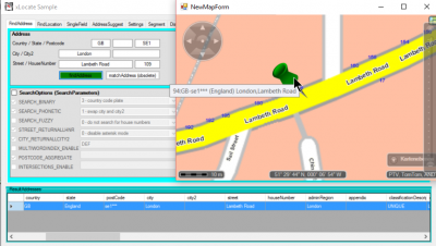

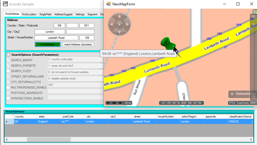

With post code "SE1" or less, I'll get only street (reference point), but by omitting house number and setting post code to "SE1 7" or more, I'll get the list with all available house numbers
Does anybody know, why it is not possible to get the list with all available house numbers by requesting with "SE1"?

Now I know why the housenumber isn't found in the 3rd. case.
The housenumber "109 Lambeth Road" is assigned to the city Lambeth. If the input is "109 Lambeth Road, SE1 7, London, GB" the xLocate is finding the street directory with the postalcode and the city input. So both are considered to choose the result address.
If you are searching with the input "109 Lambeth Road, SE1, London, GB" the postalcode isn't complete, therefore it isn't taken into account to find a street directory and it also isn't considered to find the housenumber. The xLocate is finding a street segment "Lambeth Road, London, GB" which fits better to the input than "109 Lambeth Road, Lambeth". That's the reason why the xLocate is returning only the street section and not the housenumber.
