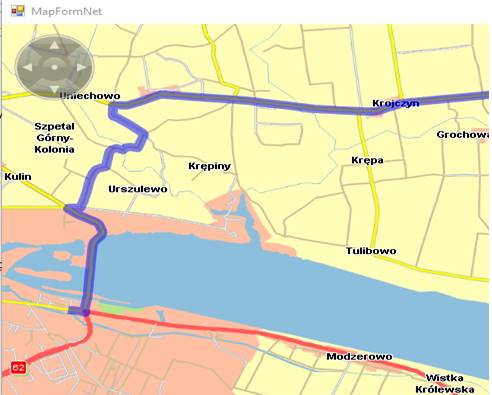

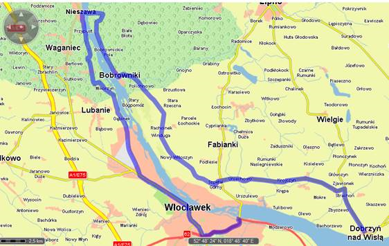

Problem is on the next step when i trying to set route.
Route has one segment of road ( bridge ) with ban > 30000kg.
Start point 19,12901 52,65209
End point 19,31928 52,63907
When i used My invidual profile or your mg-truck-40t route goes over this bridge ( of course i using TruckAttributes enabled=true ).
When i changed value emptyWeigt in section like that i received correct result.
<Weight emptyWeight="40000" totalPermittedWeight="40000" loadWeight="25000" />
Whatever i type in rest doesnt matter on route.
I cant find additionally information about more parameters, maybe i didint add one of them to respect all attributes from section Weight.
Im using Map HERE 2017.1
Thank you very much for your help.

Hi Sebastian, hi Bernd,
a segment with a MAX_WEIGHT property will be blocked if the sum of Weight/@emptyWeight, Weight/@loadWeight, and Trailer/@emptyWeight is larger than the maximum weight stored at the segment. Since internally the maxWeight at the segment is stored in 10 kg units and we calculate with integer arithmetic the sum of these weights must be 10 kg more than the maximum weight at the segment (30010 kg) in order to block the segment.
Note also that the parameters in the Vehicle element of the profile are considered for truck attributes only if Course/AdditionalDataRules/VehicleSpecific/@enabled=true.
I tested the mentioned bridge with our internal tool and it works as expected. If the problem remains when the sum of the emptyWeight and loadWeight is larger than 30010 kg there is probably another issue with the request and profile.
Frank
