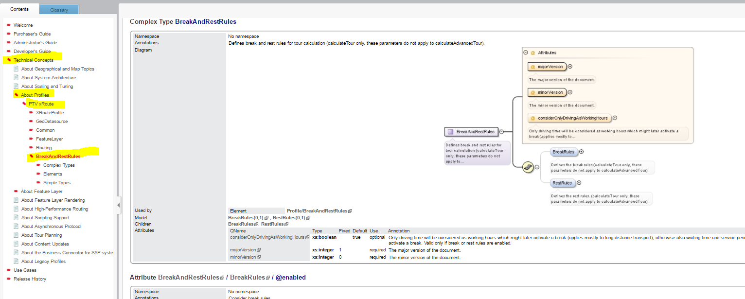

Hello Niko,
you can store the settings in a server side XML profile:
http://127.0.0.1:50030/manual/Default.h ... s%7C_____0
screenshot from the documentation of the profiles
