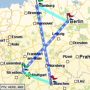

I created a little scenario that shows what the effects of this feature are.
The global setup of the scenario: <br />Depot is in Stuttgart, the arrows show the relations (pickup=freen, delivery=red)
Imagine that we have two AB orders:
  • the Depot is located int Stuttgart
  • ORDER 1 : a single item of product 1 is brought from Karlsruhe to Berlin
  • ORDER 2 : a single item of product 2 is brought from Hamburg to Munich (=München)
Here are the results - the total distances of the tours and chains are mentioned in brackets.

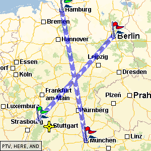

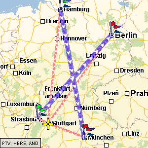

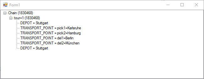

Without enforcing the separation of the products the potential of optimization is the highest one. The two orders are picked up in a row and delivered afterwards.
Without restrictions - just a single tour with shortest distance

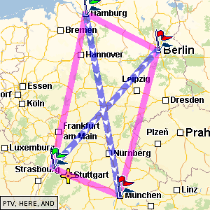

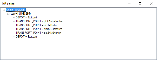

By applying the new ProductIncompatibility() {<br />incompatibilityType = ProductIncompatibilityType.NOT_AT_SAME_TIME,<br />productId1 = 1,<br />productId2 = 2<br />}<br />the server ensures that both products are not on the truck at the same time but he doesn't have to get back to the depot between the orders.
productId1 = 1,
productId2 = 2
Single tour but not AT SAME TIME

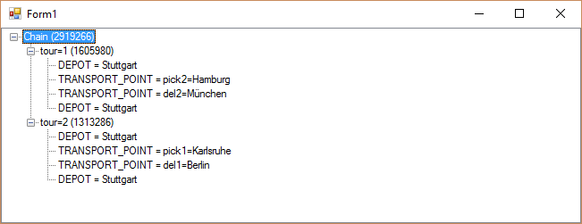

With <br />new ProductIncompatibility() {<br />incompatibilityType = ProductIncompatibilityType.NOT_ON_SAME_TOUR,<br />productId1 = 1,<br />productId2 = 2<br />}<br />the server has to get back to the depot before taking care of the other order. So in the end there have to be TWO tours instead of one.
With
productId1 = 1,
productId2 = 2
Not even at same tour - worst distance
I hope this shows that you can solve the customers usecase.
