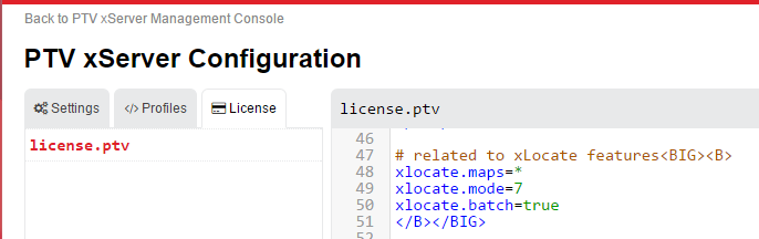

Please check your license: the error mentioned in the post occurs e.g. if the license.ptv doesn't enable batch processing.
Another potential cause to be checked (but probably not this time): is geocoding in general supported? (xlocate.mode=7 enables 1+2+4)
Did you also use the batch version of findAddress before your holiday?
- 1 = geocoding
- 2 = reverse geocoding
- 4 = poi search
