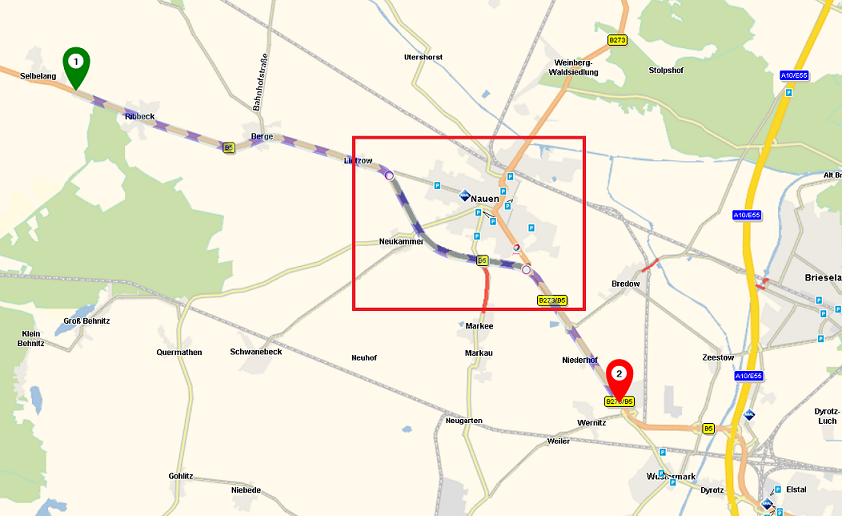

Good morning,
I created a Windows application for route planning. When planning a route, it happens that I have a route planned in spite of a closed road (no entry). I can not to figure out which parameters I have set wrongly.
For example, bypass german town of Nauen
Thank you
Vladimir

Vladimír
Vladimír Plachý, DiS.
Posts: 3043
Re: Route planned in spite of a closed road
meanwhile we reproduced the issue:
The blocking displayed in the map is a PTV_TrafficIncident (and not a TruckAttribute).
As traffic incidents are time dependent it is important to be aware of the reference time of both ROUTE and MAP:
If the map visualizes the current datetime as reference but the routing refers to a completely different time the route might seem to be invalid.
