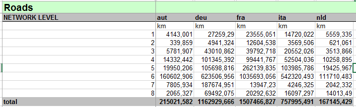

The problem we have at this point is that the data providers deliver their own data values
reflecting a hierarchy between those roads but this structure doesn't match 100% with the
model used within the engines / the binary maps. So sometimes two roads of the same
structure (but in 2 different countries) may belong to different NCs. Or two roads
in the same country with sligth differences are put into the same NC because the
differing property isn't part of the matching process.
I know that this is not 100% satisfying but unfortunately I do not have more
details about this.
Just to get some awareness of the data quality, taken from a current EU CITY map. Best regards Bernd
