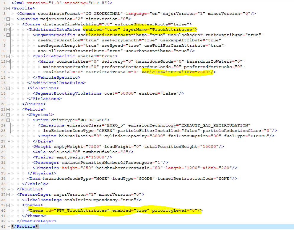

Re: vehicle profile
Hello Francois,
to be a bit more offensive than Joost:
You have to take care to activate the additional data resources such as feature layers or RoadEditor layers.
Otherwise the properties you mentioned won't be taken into account. And in fact I already faced several customers who spent a lot of time in proper configuration of properties but didn't activate the data. So they computed tours without the necessary detours and used streets that were forbidden. Especially with xTour this is difficult to see because quite often the routes aren't visualized.
This snippet contains <br />- activation of the traditional TruckAttributes<br />- activation of the state-of-the-art feature layer TruckAttributes<br />- the physical dimensions and further relevant properties of the vehicle and so on<br />This example is based on a case where the customer wanted to be sure not to use mountain passes where trailers are forbidden.
