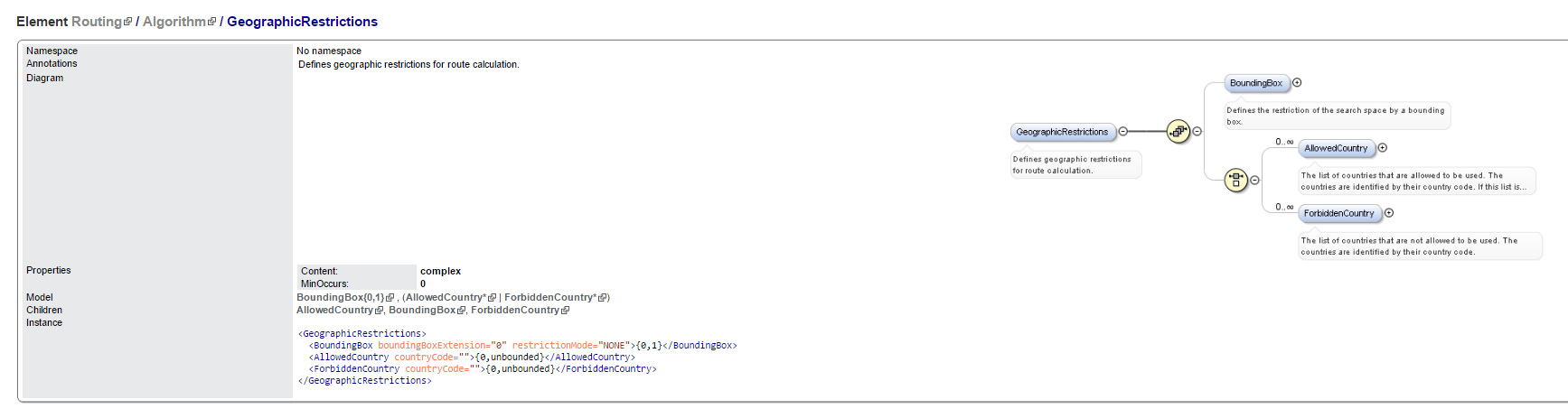

Hello Dennis,
sounds like you could benefit from our Geographic Restrictions:
http://xserver.ptvgroup.com/fileadmin/f ... strictions
Shows tha positive / negative lists.
As xTour requires setting such properties in the profiles on server side you can easily create lists of allowed or forbidden country (only one of them by the time).
Check it!
Regards Bernd
Posts: 3003
Re: Don't cross country border lines
Here is a sample snippet:
<Profile>
			<Algorithm>
				<GeographicRestrictions>
					<AllowedCountry countryCode="49"></AllowedCountry>
				</GeographicRestrictions>
			</Algorithm>
		</Routing>
	</Profile>
Posts: 3003
Attention: here is some important restriction of the country code!
CountryCode
In other words: you have to use the PTV specific code to identify the allowed / forbidden countries!

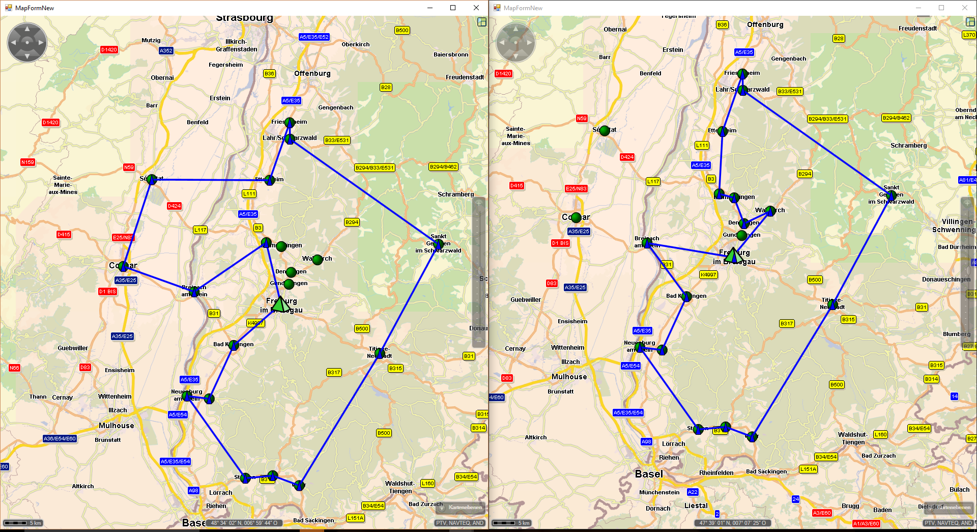

Here is another important hint dealing with this challenge:
Since xTour 1.22.0.0 we invented the DirectDistanceFallback parameter:
Improvement: From now on only tours with proper routings are planned and with the new switch useDirectDistanceFallback the old behaviour could still be used (e.g. to plan inaccessible orders with a direct distance approximation).
Therefore you have to consider this switch when applying a profile that should prevent you from visiting unwanted countries:
If both
  • Routing geometries
  • Scheduled locations
should consider the whitelist countries the directDistanceFallback has to be disabled!
Left map: though the dima is based on &quot;Germany only&quot; the tours consider locations in France (west of Rhine). This is because the distances and routing times are estimated based on the FallBack mechanism.<br />Right map: The dima is based on &quot;Germany only&quot; and the fallback is disabled. Therefore French locations remain unscheduled.
Left map: though the dima is based on "Germany only" the tours consider locations in France (west of Rhine). This is because the distances and routing times are estimated based on the FallBack mechanism.
Right map: The dima is based on "Germany only" and the fallback is disabled. Therefore French locations remain unscheduled.
