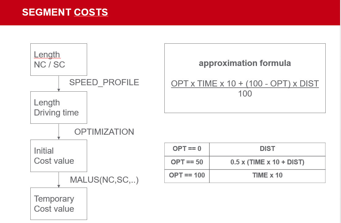

I attached an image that explains the mechanism behind the static speed values. So when our data department receives the raw data from the providers TOMTOM and HERE we map the input data into PTVs proprietary structure and during this process we determine the network and speed classes for all the segments. While some countries have low limits (such as France, limited to 130) others have higher speed classes (at least partial) such as Germany (STRIKE
I'm not sure how to understand the other parts of the post? Could you explain more in detail what you need?

Thank you very much for the instructive infographics! I didn't know there are 8 speed classes used internally!
As to my general question, I want to know, how the travel time is calculated for a route/map segment.
Previously I assumed that underlying map exposes only NC (network class) for segments, and xServer somehow (magically) mapped [min;max] interval of the specific NC to a driving time along the map segment.
Do I understand correctly, that the segment information from the map is more robust and also provides SC (speed class) of each segment? And this allows for a concrete speed calculation? For example if a segment has NC=2 and SC=2, the speed for this segment will be something like 25 + (85-25)*5/7 = 68 (i.e. somewhere between 25 for SC=7 and 85 for SC=0, proportionally to SC value).

There you go!
After all this explains how we compute a best route: it is the path that produces the least amount of costs!

Thank you very much, that answers all my questions!
