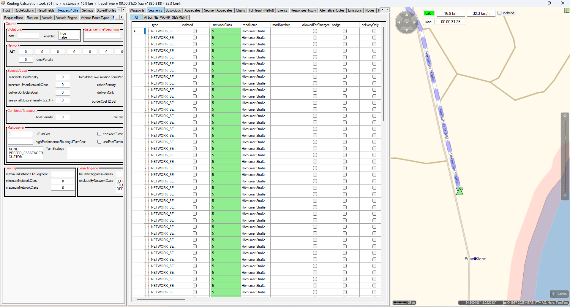

With a "usual" (or default) linking which allows all network classes vrom 0 to 7 the linking connects the waypoint to the closest bicycle lane.  Though the linking was sucessful the start of the route is seen as VIOLATED because a car is not allowed to drive on that type of road,

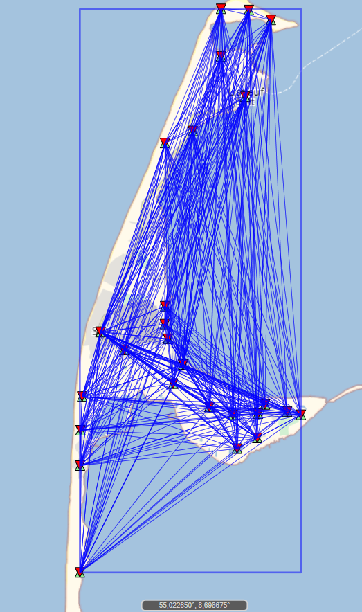

With the regular settings many relations on the island are violated (the red lines in the image)

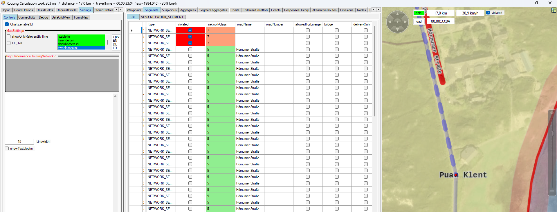

Now I created a new HPR which sets the allowed network classes to 0..6. So the bicycle lanes are forbidden in the linking.
Now this HPR creates routes without violations. Though there's a significant distance between the inpu8t coordinate and the linked segment on the road network.

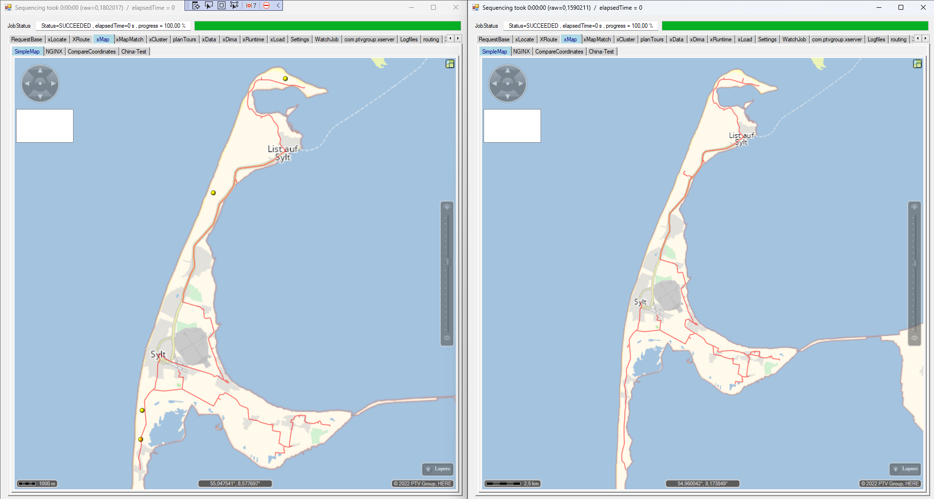

:!: With this kind of underlying HPR and LINKING the tour optimization does no nonger depend on the PlanToursOptions.
Left: unscheduled orders due to violated relations in the DIMA.  &quot;ignoreRouteViolations&quot;  and &quot;ignoreReachabilityViolations&quot;  are set to FALSE.<br />Right: all orders scheduled (no red/yellow ball icons)
Left: unscheduled orders due to violated relations in the DIMA. "ignoreRouteViolations" and "ignoreReachabilityViolations" are set to FALSE.
