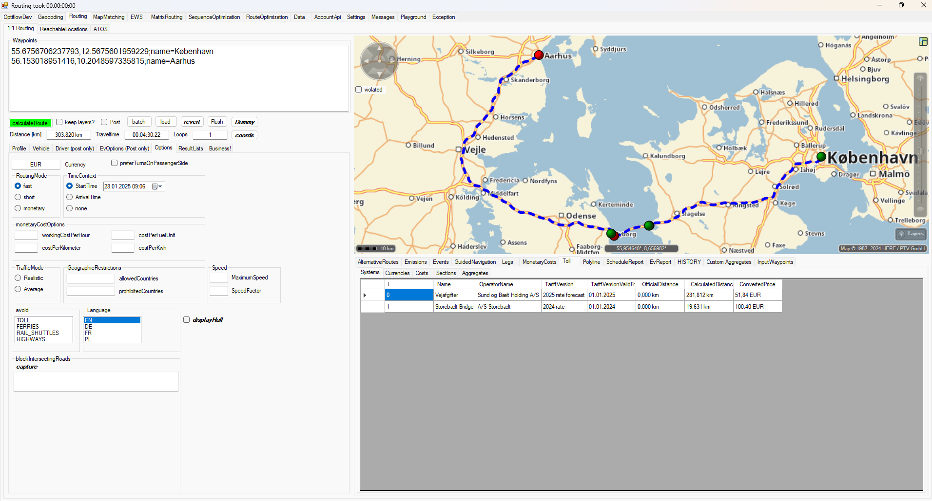

  • :!: Please ensure to apply a proper time consideration context, e.g. StartTime > 1.1.2025 (as with any other routing if you are looking for proper toll)
  • The current toll scenario is labelled as a forecast - we are waiting for the Danish government to ratify the prices.
    As you can se from the screenshot (computed on PTV Developer on 28.11.2025) the new toll in Denmark is currently a forecast

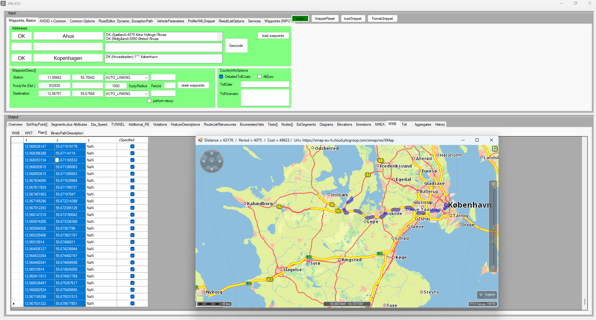

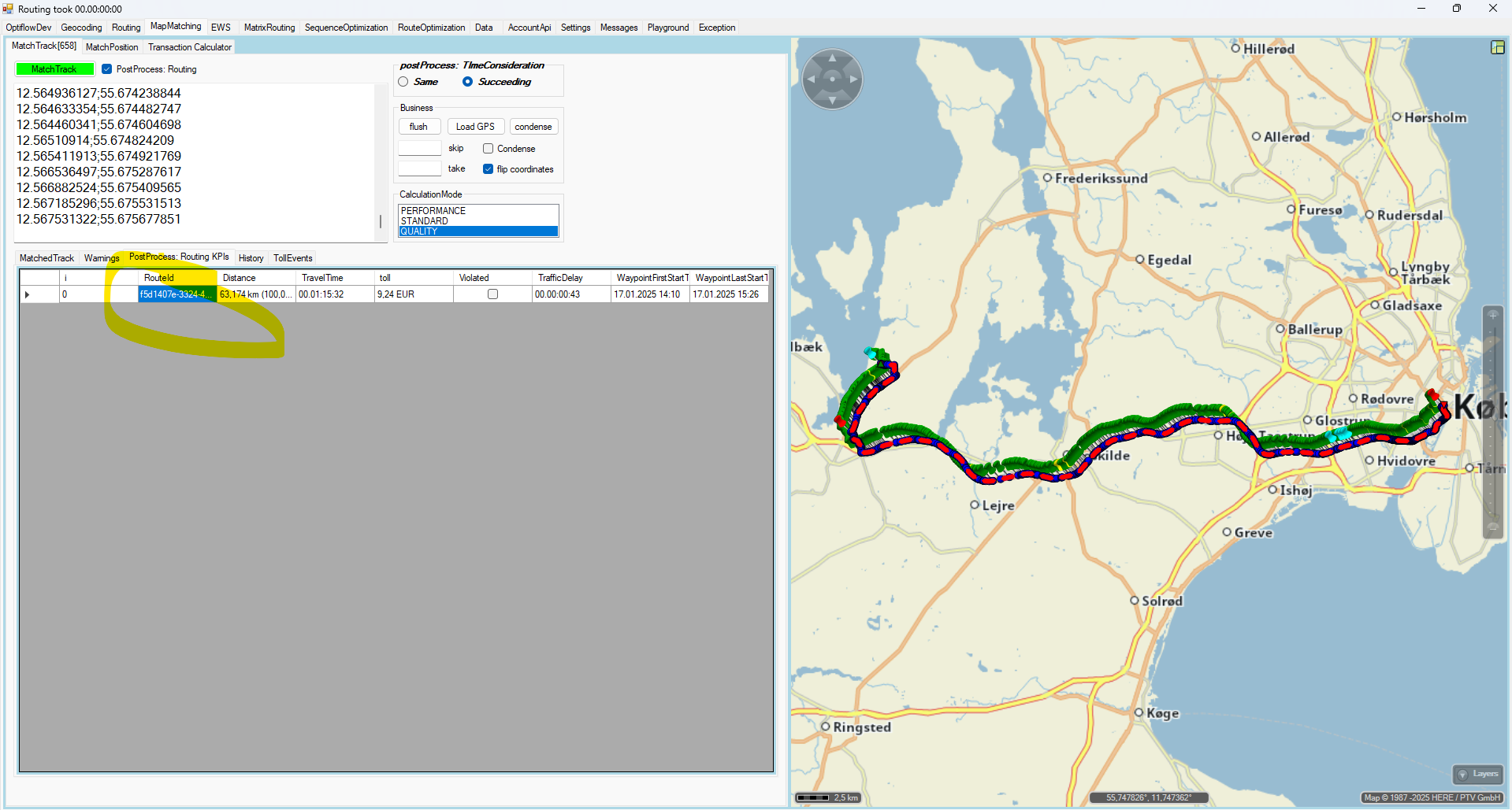

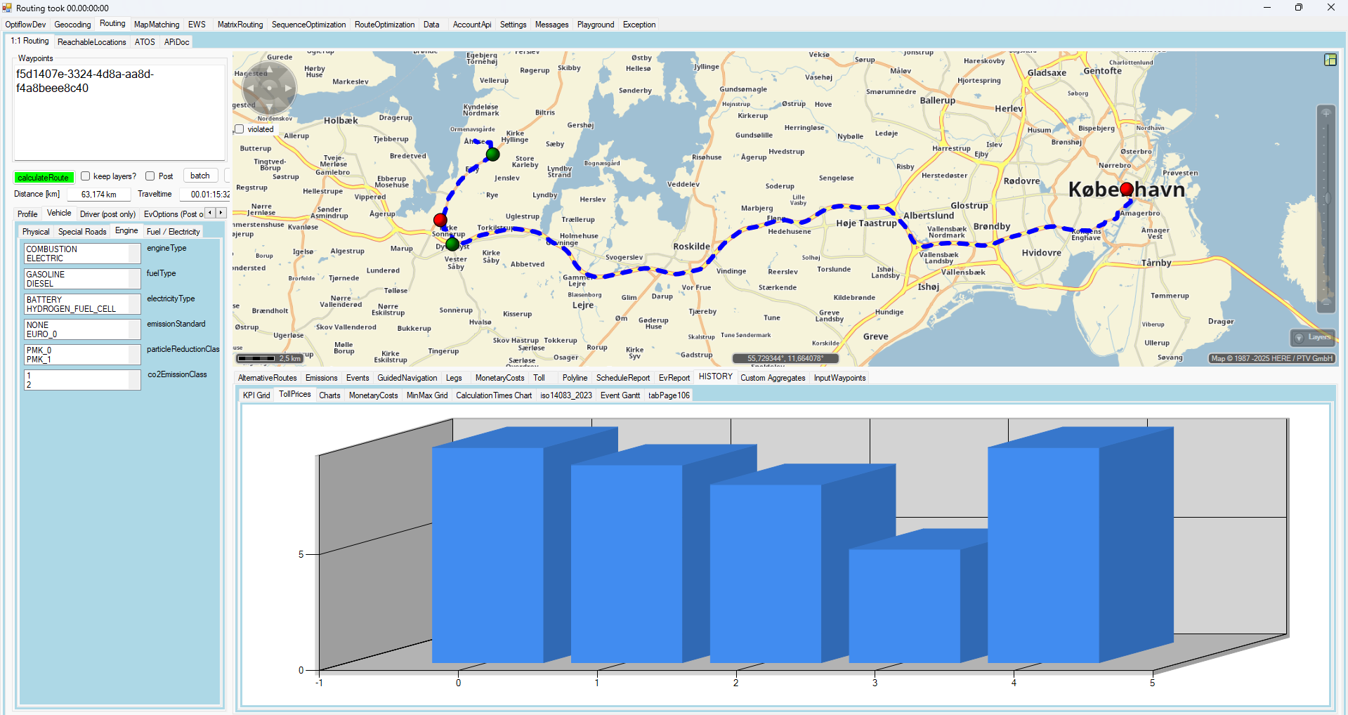

The following approach is just a workaround, but please take a few seconds to understand the idea behind it:
The core idea is to replace the insufficient xServer1 basic toll with KPIs gathered through PTV Developer
  • Create the route as usual through the xRoute 1 API
  • Use the polyline to create a Developer.MapMatching which returns a route ID
  • Use the Developer.Routing API with the RouteID and create the detailed toll based on the reconstructed route
Known flaws:
  • Route lists with more than 2 waypoints?
