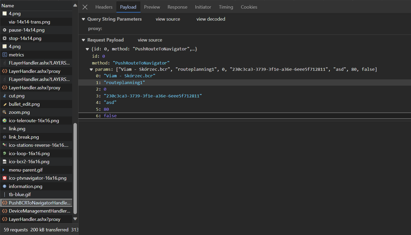

We are currently in the process of developing an app for our client, which will seamlessly integrate PTV Navigator with the xServer that we've already integrated into our TMS system. We are exploring ways to enhance this integration further.
Is there a possibility of sending BCR files, similar to the functionality available in Map&Guide, for closer inspection within PTV Navigator?
Thank you for your assistance.
P.S. Here is Request that goes with PTV Map&Guide Internet
Dominik Zalewski
- Within PTV Navigator, we receive a unique ID for each device, which can be found in the settings.
- We provide this ID to Map&Guide Internet when configuring devices.
- After performing calculations, we can directly export data to the respective device listed.
Dominik Zalewski
