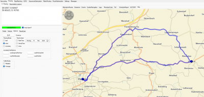

Quick question about MGI & xServer1 comparsion.
One of our client is missing the possibilities in our solution for considering road blocks when routing.
In MGI there are 3 settings for this one, shown in the attached picture:
- Include all traffic disruptions
- Include all blocks
- Only include permanent roadblocks...
Could you describe the difference between these 3 settings, and also tell us which parameters have to be setted in the routing profile to get the same results as in MGI?
It must be somehow with the PTV_SpeedPatterns, and PTV_TrafficIncidents layers, but we're a bit confused, how to pair them with the MGI settings.
Thank you in advance!
Peter

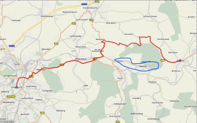

I've came with an example. Maybe this could bring us closer to the solution.
DE 09 Chemnitz
DE 09569 Oederan.
1.
Map&
Guide Internet:
As you can see, there is an ongoing road work, between Flöha and Falkenau.
MGI knows this one, so it skips that segment and gives a longer, but possible route.
2. xServer1:
On the raffice
map layer, we also visualize this roadblock, however in xServer1 this roadblock is bypassed.
I also attached the xServer1 request.
Thank you,
Peter

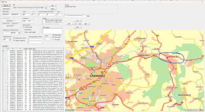

Posted: Fri May 12, 2023 7:46 am
HI Peter,
here's some footage... processed through
xroute-eu-h-test / Raw Request Runner:
- screenshot that viusualizes all traffic data based on the GEODATA SOURCE LAYER "traffic.ptv-traffic.default" - so displays ALL categories
Here's a routing request with the option set to consider that layer

- The routing request's result - including the detour
Is this what you've been looking for?
