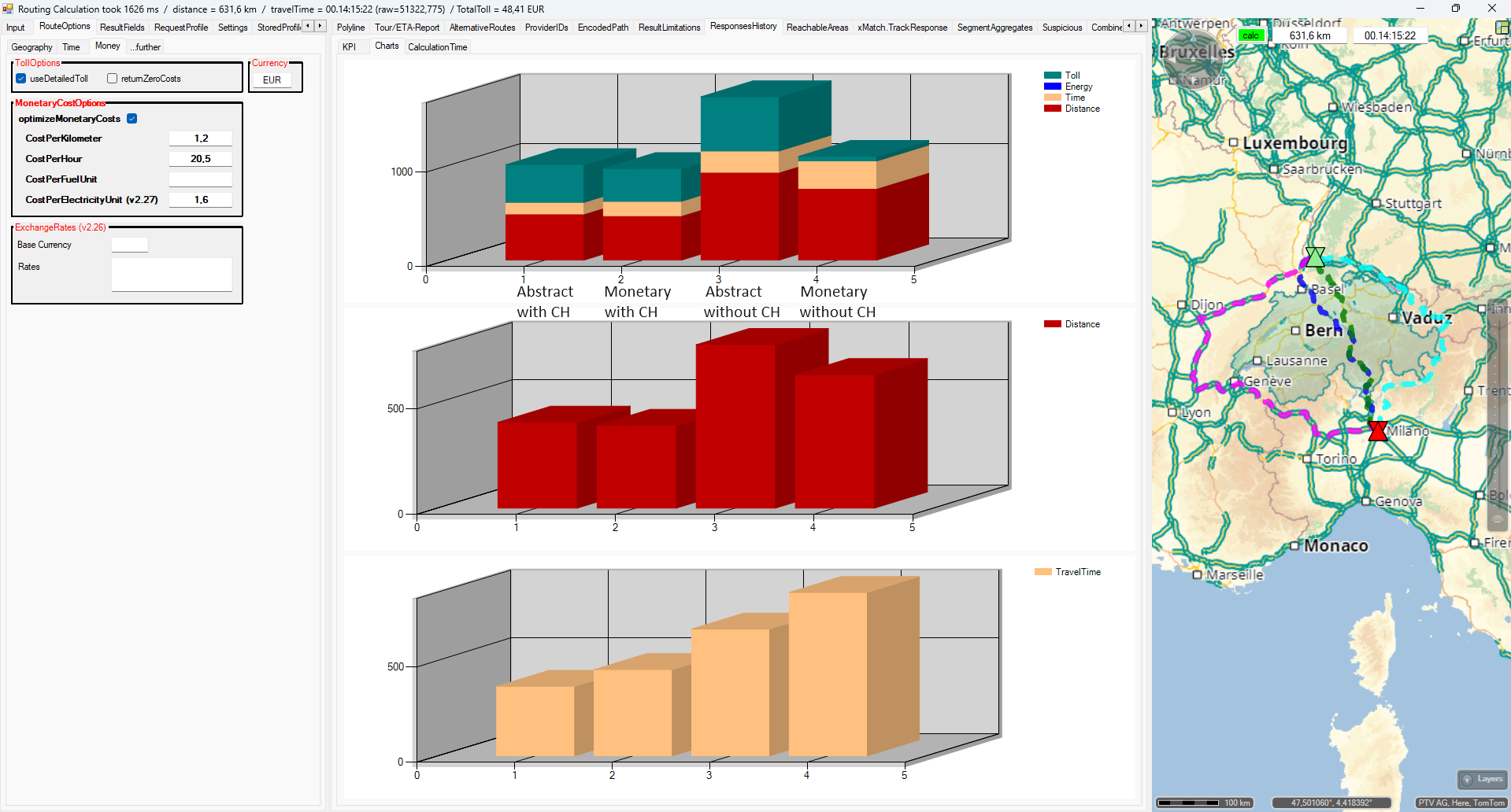

      BLUE and GREEN are driving through Switzerland but they do not consider waiting times at customs. The purple (Abstract) and cyan (Monetary) routes are applying the geographic restriction ForbiddenCountries=["CH"] to enforce the detours which are cheaper from a dispatchers experience.

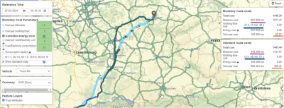

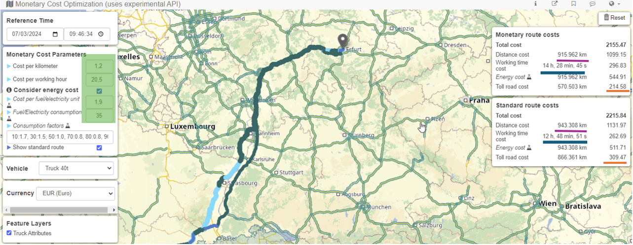

An example Lyon (FR) to Erfurt (DE):
Case 1:
Price per working hour................. = 20,5 €
Price per distance...................... = 1,2 €
Price per "fuel/energy" consumption = 1,9 €
In this case the result is a tradeoff and the returned route is more feasible by the driver saving around 100 € of toll costs and 30 Km of route but using around 1h 35m more than the standard.
